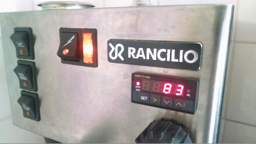

                    Hey urglik,
                    I'm interested in this free SCADA software for the Solo controller, but couldn't find info about it online - do you have a link for it?
                    Other than the software, the controller looks very similar to any basic + cheap PID temperature controller eg:
                    http://www.dx.com/p/xmt7100-1-3-screen-pid-intelligent-temperature-controller-black-192851#.VPZjzLOUfiE
                    These will take a measurement (Pv) , compare it to a setpoint (Sv) and then turn the output on/off to achieve the desired setpoint, using a PID process algorithm.
                    They are very simple to set up.
                    I even installed one in my coffee machine:
                    The difficulty in your application will come not from controlling the Sv, but from controlling the rate of change of temperature, I think.

                      hi jeremyh,
                      i believe that the inexpensive pid controllers on ebay, etc. do not
                      have ramp/soak capability.
                      the cheapest i could find on ebay was 75.00 and the quality i could not verify.
                      omega has them for 85 and up. (good products)
                      i chose solo, 90 and up, because of the software which you can get from this link.
                      http://ftp.automationdirect.com/pub/slsoft.zip
                      i think it's reasonable to assume this software will work other controllers.
