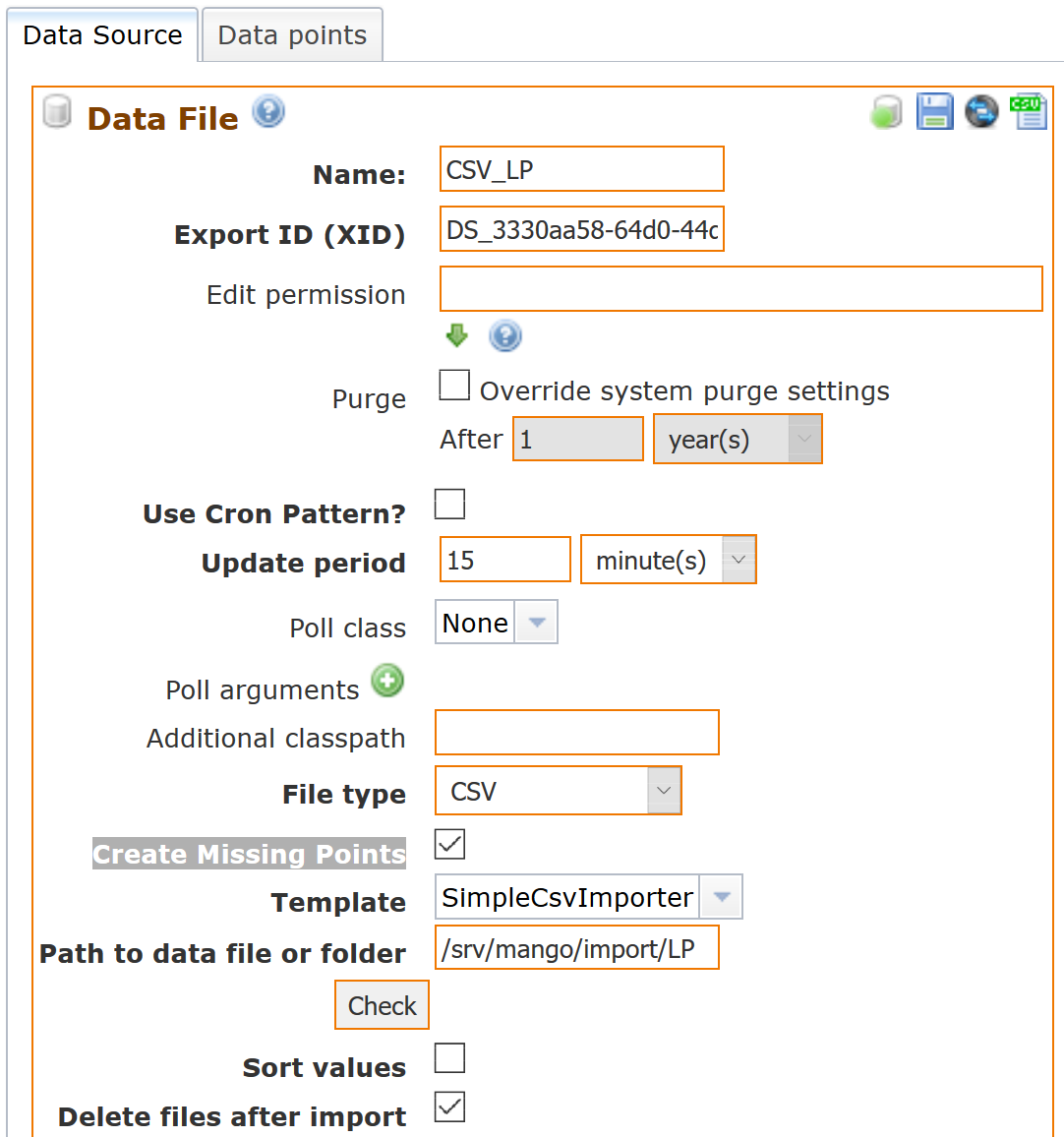

      My Data Source setup is as follows:
      Data Source Config

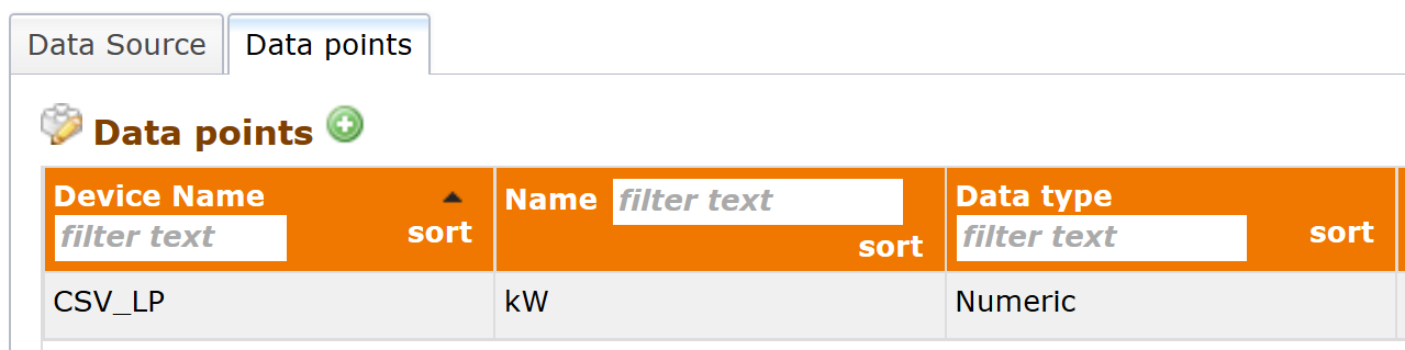

      And I've created a Data Point for the Value's of electric power (kiloWatt)
      kW Data Point
      But the log give's me the following error:

            Which I saved as a new file and changed inside the Data Source Settings to use that template...
